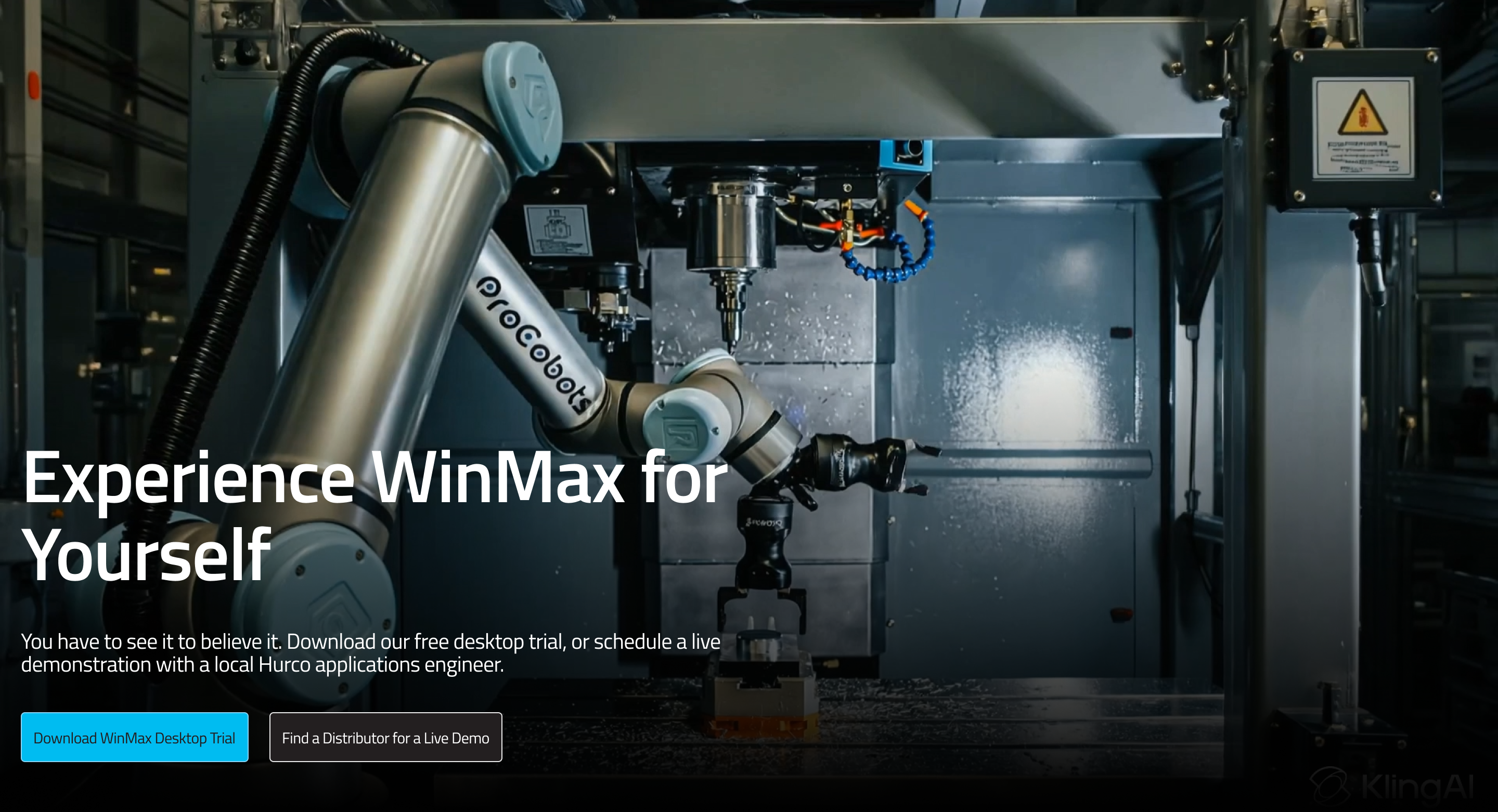

Website view:
Website view - Overlay Hero
